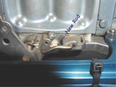

I have just found some thing out. on my holly carb the rear pots are not working it is a 4 barrel 390 (I think) The reason is the small bar that brings in the rear pots is missing. (And i thought is was quick now)Has any one got a photo of the linkage side of the same carb so as i can see whats missing. I have looked on the holley web site but no joy and i have downloaded the manual for it, but it does not show it.
Thanks
Paul

Paul is this what yuo want? Eric.

I believe you are referring to the linkage rod for the secondaries. You can get this in either progressive (top hole) or one-to-one (bottom hole). The latter gives you better response.
http://www.priveye.com/images/rod.jpg
Roscoe

thanks to both of you that will now sort me out
thanks
Paul
