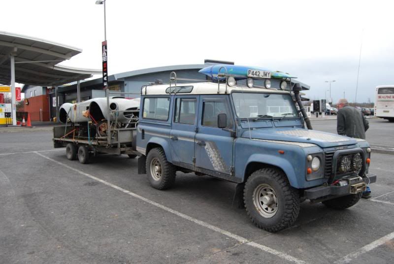

    So.... after towing it to Wales I started looking into what I had got myself into!

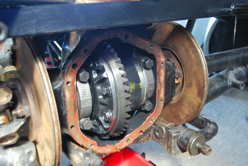

    Lifted the diff in...and to my pleasant surprise it was a 3.54 PowerLoc Diff

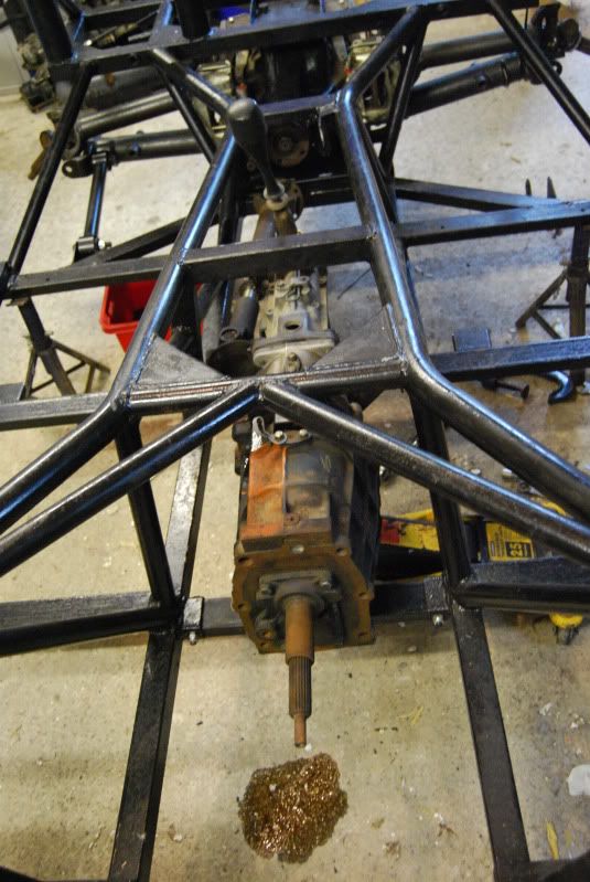

    In with the gearbox and engine mounts

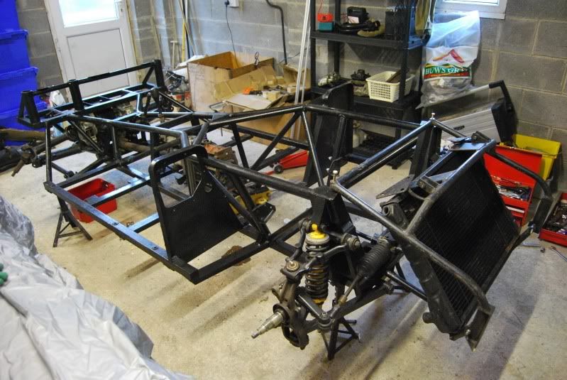

    Tested the radiator (rover SD1 2600)
    At this point I had a right battle with getting the coilovers together, ended up sending them to a local machine shop!

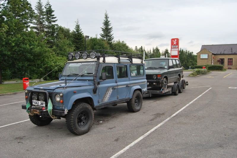

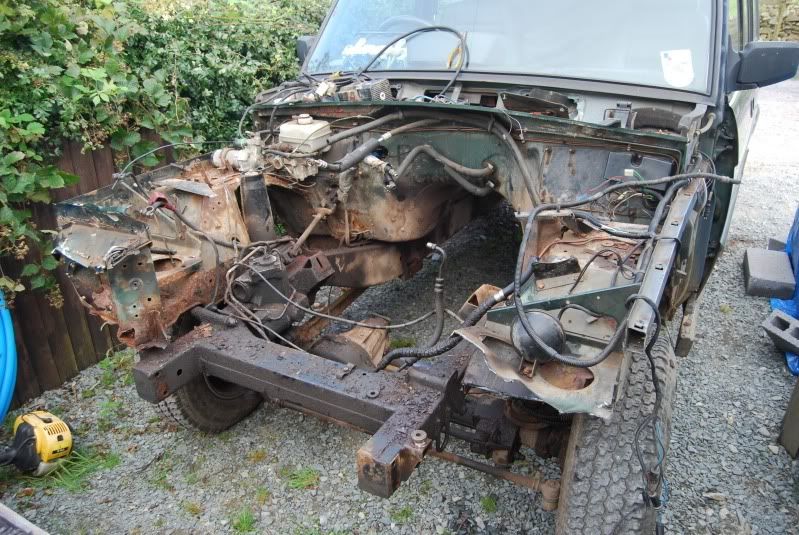

    Found myself a Donor!! A lovely 1990 MOT failure RRC with a 3.9 EFI engine for £350...So off I went in my trusty 110!

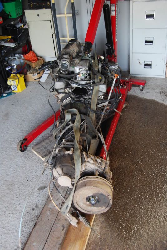

    I then stripped down the engine and started sourcing all the infamous SD1 parts like the flywheel, bell housing etc
    A trail fit of the engine showed it hit the chassis rail, and after help from here found the RRC sump to be at fault and needed a SD1 version

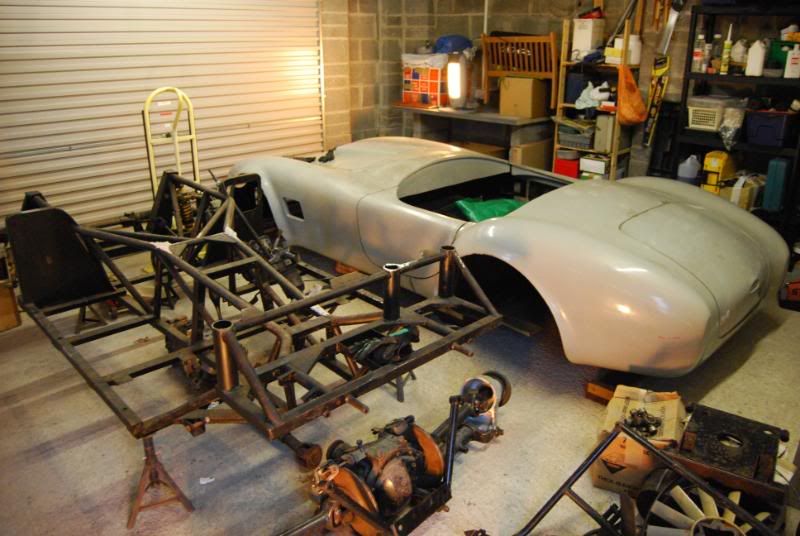

    At this point I figured it would be prudent to test fit the body and check clearances etc
