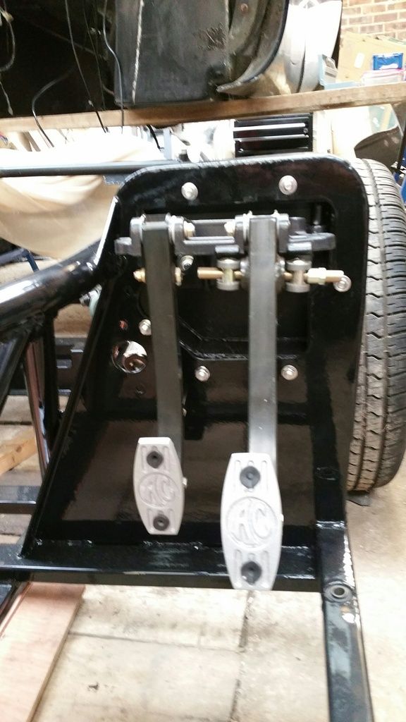

    Pedal box, sorry bit out of focus but you get the picture, obviously no throttle pedal in place at this time.

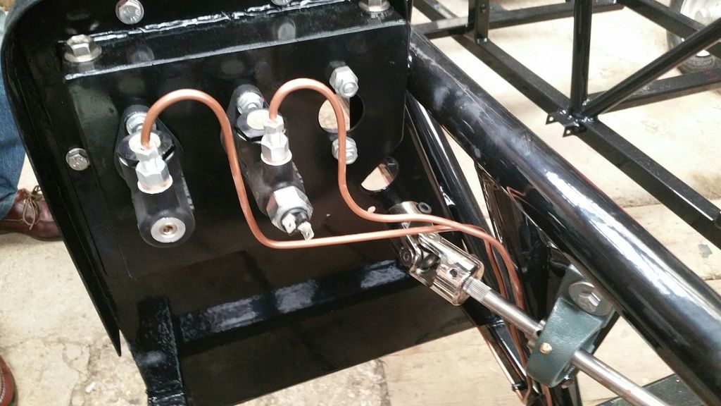

    From engine bay side, you can see that I have mounted the whole thing in a box which has the advantage of giving me another inch or so leg room which was always tight for a 6 footer in the RAM

    James. Your Tilton setup looks really good and i appreciate what you say regarding the mechanical advantage and the increased legroom.
